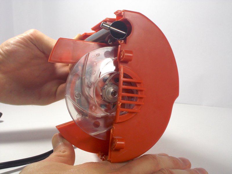

    1. Eureka 1660SP Extendable Pole Realignment, Realignment of the extendable pole: step 4, image 1 of 1
      • Once the housing is open, locate the solid chrome plated piece at the front end of the extendable pole.
      Ask FixBot
    2. Eureka 1660SP Extendable Pole Realignment: step 5, image 1 of 2 Eureka 1660SP Extendable Pole Realignment: step 5, image 2 of 2
      • On the side of the motor housing which does not hold the engine, find the center track which runs along the inside of the housing.
      • Re-insert the chrome plated piece into the center track.
