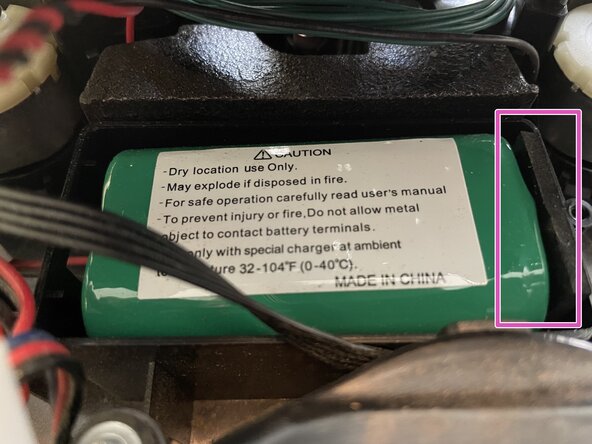

  7. Eufy RoboVac 11+ Battery Replacement, Replace battery: step 7, image 1 of 3 Eufy RoboVac 11+ Battery Replacement, Replace battery: step 7, image 2 of 3 Eufy RoboVac 11+ Battery Replacement, Replace battery: step 7, image 3 of 3
    • Lift up or remove logic board, and remove the PH1 screw retaining the battery cover.
    • Disconnect the battery. Depending on the type of plug used, it may have clips or just be pressed together tightly.
    • Work/wiggle the battery out of its holder. Using a spudger or similar pry tool to lift up on the bottom edge of the battery can help.
  8. Eufy RoboVac 11+ Battery Replacement, Battery plug variations: step 8, image 1 of 1
    • There are different styles of battery connectors that maybe used. Although the battery I ordered was listed as compatible, it came with a different connector. I soldered/spliced the old connector onto my new battery.
