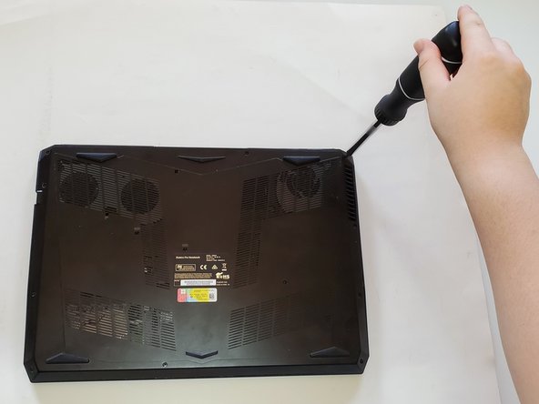

    2. Eluktronics P650 Laptop RAM Replacement: step 2, image 1 of 2 Eluktronics P650 Laptop RAM Replacement: step 2, image 2 of 2
      • Unscrew the fourteen 6mm screws on the back panel with a Phillips #00 screwdriver.
      Ask FixBot
