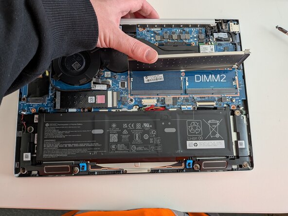

      • Unscrew 4 Phillips head screws, use prying/pick tool to start prying close to hinge to remove the bottom cover
      • Remove another screw marked with circle and lift the ram cover. SSD marked with orange arrow and WIFI-card with green arrow
      • Remove RAM stick or add another one, this one came with a single 16Gb DDR5 5600 stick
