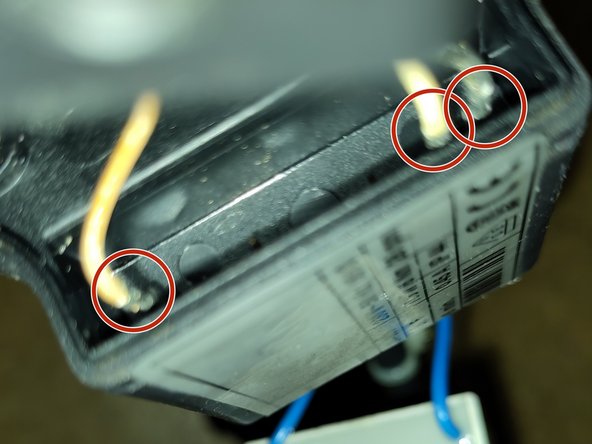

    6. Elero JA06 Disassembly, Unplug the cables: step 6, image 1 of 2 Elero JA06 Disassembly, Unplug the cables: step 6, image 2 of 2
      • The cables can be unplugged using a pair of small needle nose pliers.
      • The gearbox housing can now be completely removed.
