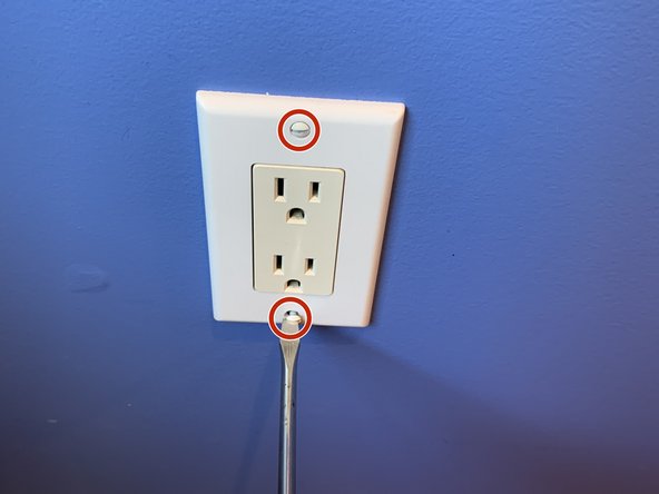

      • Remove the face plate from the wall by unscrewing the two screws.

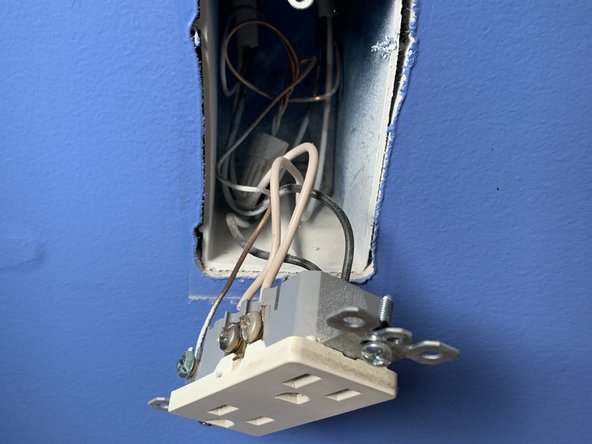

      • Pull the outlet Away from the box.
      Ask FixBot

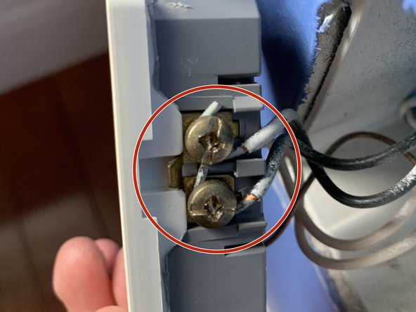

      • Remove the wires from the outlet by unscrewing the screws just enough to slip the wires out.
      • In this particular case, there are two sets of wires for both black and white. In most cases, there will only be one black and white wire.

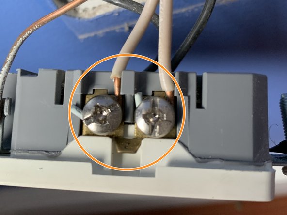

      • Attach the wires by the following
      • The black wire goes to the brass screw.
      • The white wire goes to the silver screw.
      • See how there are two silver screws? It doesn’t matter which one you use.
      • Hook your wires so they are going in the same direction as the screw is when tightening. This will help clamp the wire down as opposed to pushing it off.

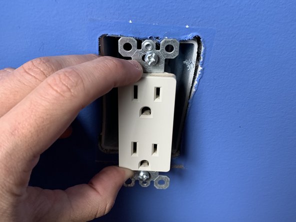

      • Insert outlet back into box.
