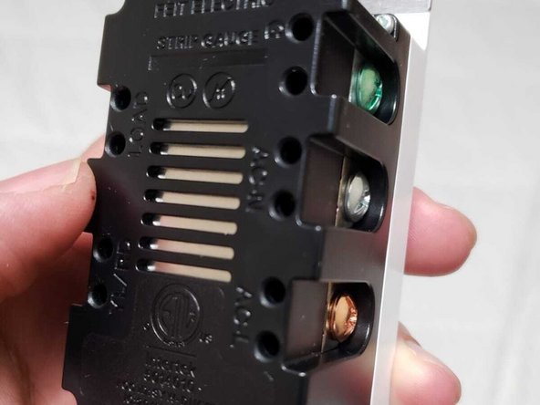

      • This is the BACK of the new dimmer switch. We are replacing a SINGLE Pole switch so we will only need the 4 color marked holes on the picture. Ignore the holes marked as YL/RD as they don't apply for our switch.
      • Yl/RD : this is only used if you have a 3 way switch, which is more complex to replace. 3-way switches are where you have one light controlled with two switches, e.g. at the bottom and top of staircases to turn on a staircase light.
      • We will be working with the RED labeled squares in the picture and ignore the blue circle pins.
      • Loosen the screws of the dimmer so the wire can be pushed in properly and then tighten them once the wire is in.
      • Push the correct wires in their corresponding holes based on the markings we did in previous step.
      • Note the color coordination of the screws for each terminal AC-L (Live/Black wire) AC-N(Neutral/White wire) G (Ground/bare copper or green wire).

      • Once the screws are loose, insert the appropriate wires (as marked previously) in their appropriate holes on the back of the dimmer corresponding to the correct labels on the wires.
      • Please see Step 2 for the color outline for the wires in my picture. I labeled my wires to correspond with the correct terms behind my dimmer in the picture.
      • Make sure the wires are inserted properly and securely all the way to the end of the hole before tightening the screws.
      • I have two bare coper wires in this picture as I am joining two dimmers to work next to each other.
      • After tightening the screws, check to see that the wires are securely held in the holes and won't come out if you pull on them.
      • If the wires come out while checking, then just loosen the screw as much as possible, push the wire back in and tighten the screw again securely.
