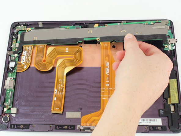

  6. Eee Pad Transformer Prime TF201 Front and Back Cameras Replacement: step 6, image 1 of 1
    • Remove the battery (secured by six screws and a white wire connector) by following the removal portion of this battery replacement guide.
    • The device that we wrote this guide for did not come with a battery, so we cannot include it in our own guide steps.
    • The battery is removed during all repairs to protect against short circuits, shocks, and internal damage to the device.

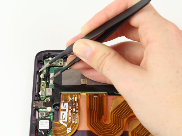

    • Use tweezers to pull back the strip of black tape covering the connection between the electronic portion of the lock and volume buttons and the motherboard.
    • Push the black part out of the white part of the connection using tweezers.

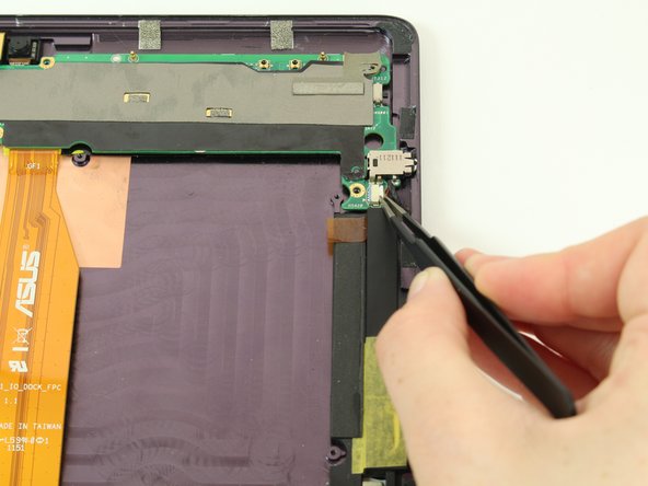

    • Using tweezers, pull the black part of the connection between the mother board and speakers out of the white part of the connection.

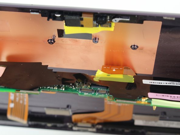

  16. Eee Pad Transformer Prime TF201 Front and Back Cameras Replacement: step 16, image 1 of 2 Eee Pad Transformer Prime TF201 Front and Back Cameras Replacement: step 16, image 2 of 2
    • The motherboard will still be attached to the device by ribbon cables and tape located near the cameras. Gently pull the tape off the back of the mother board to release it.
    • Ignore the ribbon cables still attached to the mother board. Fold the mother board down towards the bottom of the device.
