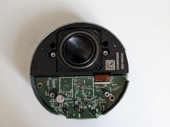

    4. Echo Dot 3 Mic/LEDs/Button Replacement, Insides: step 4, image 1 of 3 Echo Dot 3 Mic/LEDs/Button Replacement, Insides: step 4, image 2 of 3 Echo Dot 3 Mic/LEDs/Button Replacement, Insides: step 4, image 3 of 3
      • Unscrew the 3 T6 Torx screws,
      • and lift the flex cable connector.
      • After that, very carefully remove the PCB/Power supply (no idea).

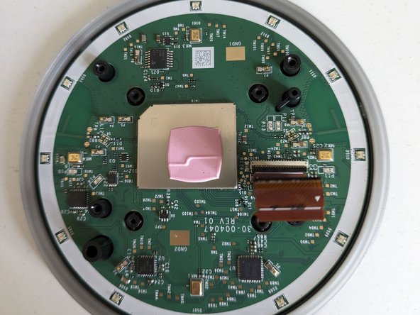

    5. Echo Dot 3 Mic/LEDs/Button Replacement, Middle part: step 5, image 1 of 2 Echo Dot 3 Mic/LEDs/Button Replacement, Middle part: step 5, image 2 of 2
      • Remove the 4 T6 Torx screws (2 different lengths!)
      • Slowly Remove the Middle part
      • Be very careful while removing the middle part, so that you don't damage the cable!

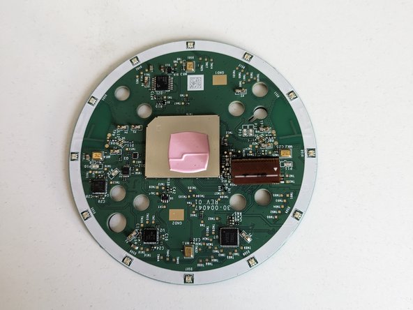

    6. Echo Dot 3 Mic/LEDs/Button Replacement, Top part: step 6, image 1 of 3 Echo Dot 3 Mic/LEDs/Button Replacement, Top part: step 6, image 2 of 3 Echo Dot 3 Mic/LEDs/Button Replacement, Top part: step 6, image 3 of 3
      • Remove the 4 T6 Torx screws,
      • and lift the plastic to remove it.

    7. Echo Dot 3 Mic/LEDs/Button Replacement, Motherboard: step 7, image 1 of 3 Echo Dot 3 Mic/LEDs/Button Replacement, Motherboard: step 7, image 2 of 3 Echo Dot 3 Mic/LEDs/Button Replacement, Motherboard: step 7, image 3 of 3
      • Simply flip the device to separate the:
      • Motherboard and
      • Buttons from each other.
