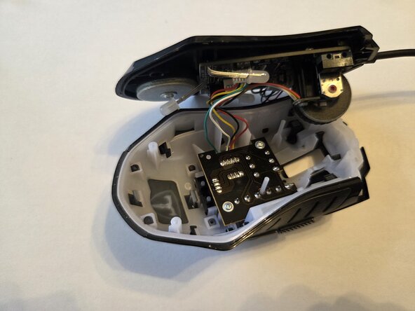

      • Potential for device damage: A delicate cable connects the top and bottom shells. Do not pull them completely apart yet.
      • Gently lift the top casing to open the mouse and reveal the internal components.

    4. Eastern Times Tech T7 Mouse Micro Switch Replacement: step 4, image 1 of 2 Eastern Times Tech T7 Mouse Micro Switch Replacement: step 4, image 2 of 2
      • Use tweezers to carefully pull the internal cable connector straight out of its socket.
