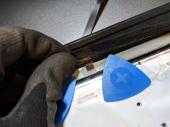

      • We start the opening process at the connector side. It consists of 2 parts: the top which is made from plastic and the bottom which is made from aluminium. They are hold in position by pins (so don't use a lot of force when you feel a resistance) and glued together.
      • Heat it up and gently cut between the top and the alcantara. Watch out not to tilt your opening tool, otherwise you will likely cause permanent damage on the alcantara. Keep it open with the opening picks and work your way along the top until it pops up.

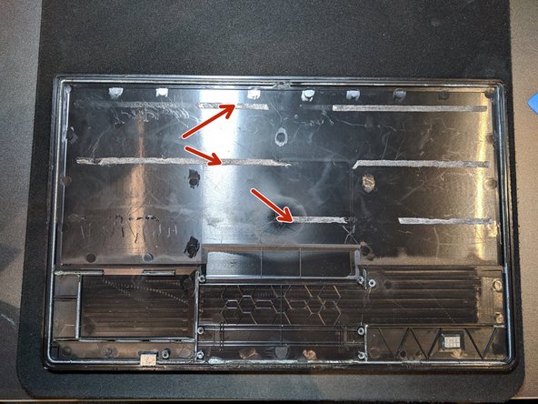

      • Next we will remove the bottom plate. The alcantara is glued on a plastic frame. You don't need to remove the alcantara.
      • Start at the connector side. Use your hairdryer / heatgun to weaken the glue. Cut between the frame and the alcantara. Don't tilt your opening tool. 'Save' your progress with the opening picks.
      • The keyboard an the back plate is separated with a white plasic foil. Try to keep it on the keyboard side. See those 3 stripes of glue? That's where it's attached to plastic frame. The connection can be unstuck with heat and your opening tool.

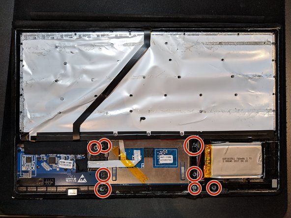

      • Proceed like done in step 3 but now don't cut so deep into the keyboard preventing damage to the battery and the trackpad.
      • Now the trickiest part comes: there are eight spacer located around the trackpad. This glue is extremly hard to loosen. First make shure that the rim of the frame is parted from the keyboard. Heat up the area around the spacer. Use the spudge to apply the pressure right at spacer. This should prevent a breaking of the frame.
