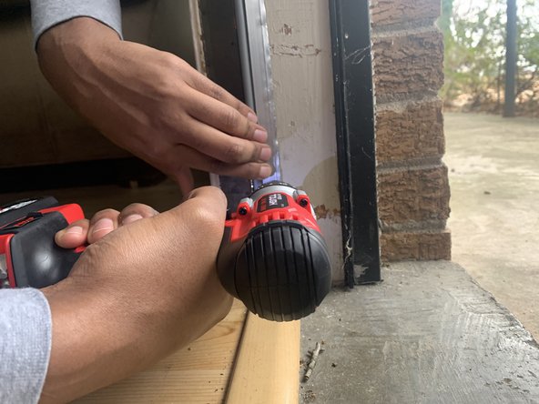

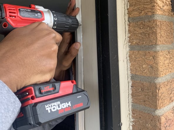

    6. Door Weather Strip Replacement: step 6, image 1 of 3 Door Weather Strip Replacement: step 6, image 2 of 3 Door Weather Strip Replacement: step 6, image 3 of 3
      • Screw the nails into the weather strip using a drill driver.
      • Make sure the drill is set to turn right to keep consistency. Keep space from the drill while holding the strip flat with your other hand.

    7. Door Weather Strip Replacement: step 7, image 1 of 1
      • Hold the drill driver horizontally to drill the last screw.
