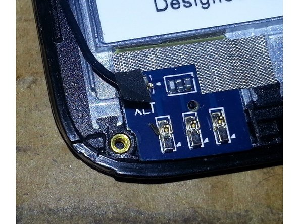

    13. Doogee Valencia2 Y100 Pro Screen Replacement, Screen Removal: step 13, image 1 of 1
      • We are now finally at the stage of removing the screen.
      • Flip the mid frame back over so that you are now looking at the front of the phone again. We will now need to use a hair dryer or heat gun to heat up the edges of the phone to loosen the glue that is holding in the screen and front buttons, to the mid frame
      • Once the glue has heated up enough you should be able to get a plastic prying tool between the glass screen and the plastic mid frame.
      • Slowly and carefully move your prying tool around the phone until the screen has been released from the mid frame. I found that the glue that holds the screen to the mid frame is not to strong, which is good.
