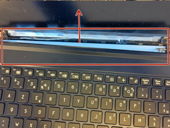

    2. Display separation for V540TU, Lower housing 2: step 2, image 1 of 3 Display separation for V540TU, Lower housing 2: step 2, image 2 of 3 Display separation for V540TU, Lower housing 2: step 2, image 3 of 3
      • Unclip the housing at the corners.
      • Lift the cover.
      Ask FixBot

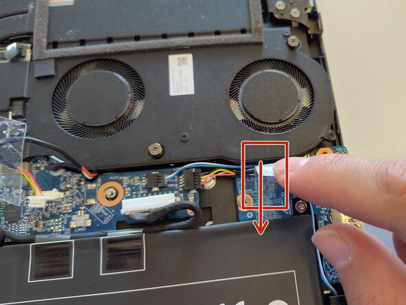

    1. Display separation for V540TU, Battery cable: step 3, image 1 of 1
      • Unplug the cable.
      Ask FixBot
    1. Display separation for V540TU, Heatsink 1: step 4, image 1 of 3 Display separation for V540TU, Heatsink 1: step 4, image 2 of 3 Display separation for V540TU, Heatsink 1: step 4, image 3 of 3
      • Unscrew the screws circled in red.
      • Remove the adhesive from the first cable.
      • Remove the cable.
      Ask FixBot

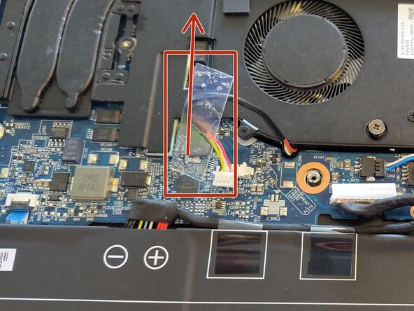

    2. Display separation for V540TU, Heat Sink 2: step 5, image 1 of 3 Display separation for V540TU, Heat Sink 2: step 5, image 2 of 3 Display separation for V540TU, Heat Sink 2: step 5, image 3 of 3
      • Remove the second adhesive.
      • Remove the second cable.
      • Lift the heat sink.
      Ask FixBot

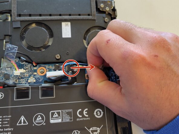

    1. Display separation for V540TU, Screen separation 1: step 6, image 1 of 2 Display separation for V540TU, Screen separation 1: step 6, image 2 of 2
      • Unplug the cable connected to the motherboard.
      • Remove the adhesives.
      • Unscrew the screws circled in green.
      Ask FixBot
    2. Display separation for V540TU, Screen separation 2: step 7, image 1 of 2 Display separation for V540TU, Screen separation 2: step 7, image 2 of 2
      • Lift the clutch hinge.
      • Remove the cable.
      Ask FixBot
