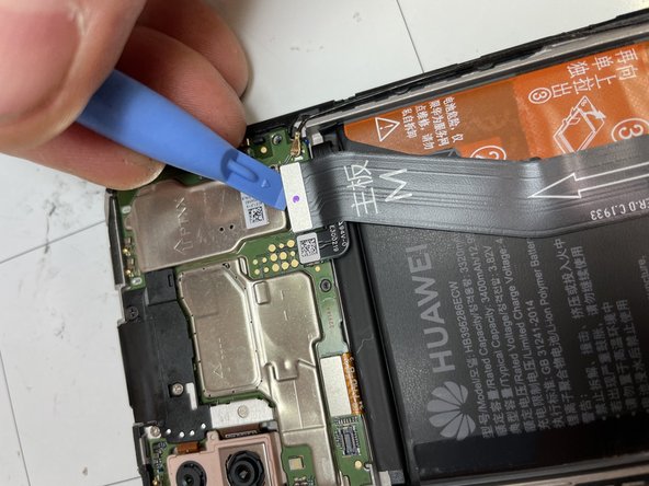

  3. Disassembly of the Huawei P Smart 2019: step 3, image 1 of 3 Disassembly of the Huawei P Smart 2019: step 3, image 2 of 3 Disassembly of the Huawei P Smart 2019: step 3, image 3 of 3
    • In the next steps you will have to unclip 4 connectors: those of the battery, the touch id, the display and the motherboard.
    • To make your work easier, unclip the connectors in this order:
    • Battery connector
    • Touch ID connector
    • Display connector
    • Motherboard connector
  4. Disassembly of the Huawei P Smart 2019: step 4, image 1 of 3 Disassembly of the Huawei P Smart 2019: step 4, image 2 of 3 Disassembly of the Huawei P Smart 2019: step 4, image 3 of 3
    • Unplug the display connector.
    • Unplug the battery connector.
    • Unplug connector of the lower logic board.
