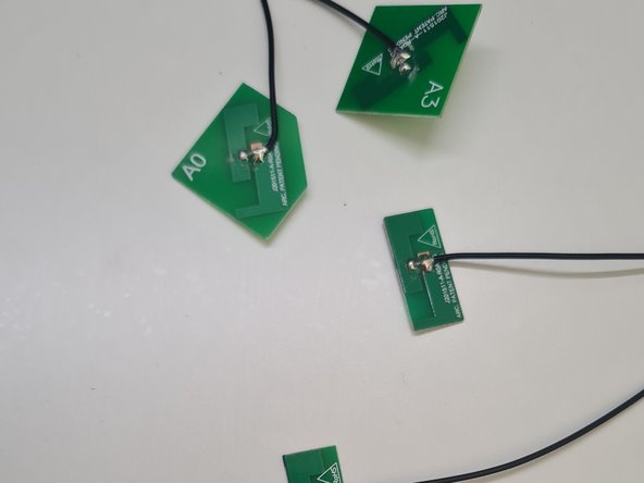

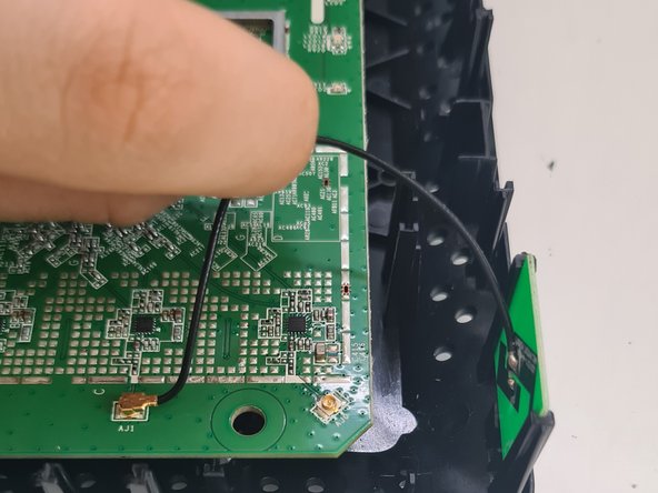

      • Inside the Router you can see some green PCBs, some are soldered while others are held in place by sockets.
      • The small socketed PCBs are antennas, they allow the transfer speed to be increased by allowing the data transfer in parallel. These antennas make it unnecessary to install external antennas as on other routers, which benefits users when installing the device on a table or shelf.
      • To extract them, we can remove the ones in sockets, if we want to remove the cable also we unplug them from the main PCB.

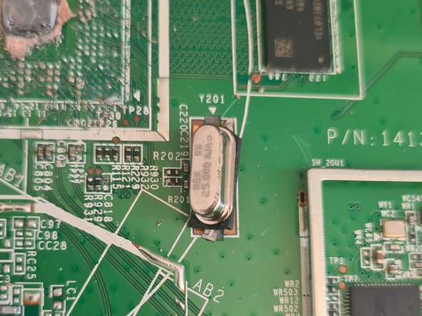

      • An oscillator is located near the processor.
      • Oscillators, from my point of view, are circuits that generate a periodic signal at the output without having any periodic input.
