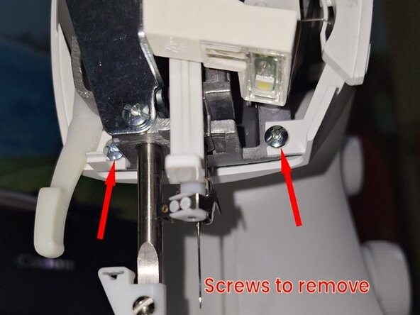

    1. Disassembling Sewing Machine Singer M2605, Cover left hand edge screws: step 6, image 1 of 1
      • Remove 2 screws (8mm) on the left hand side near the lamp, holding the edges of the back and front covers.
      Ask FixBot
