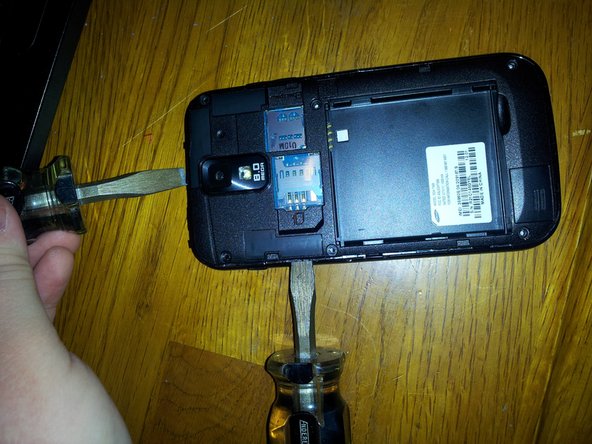

    • Insert the Flat head screwdriver into the side of the phone and pry up the back plate.
    • I used two flatheads and used one to hold the section i had pryed up until i could wedge the rest out.
    • You do have to be careful with this step not to use too much force on the back plate, however it held up pretty well on mine.
    • Once you have all the sides pryed loose the back plate should just pop right off!

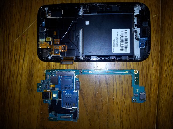

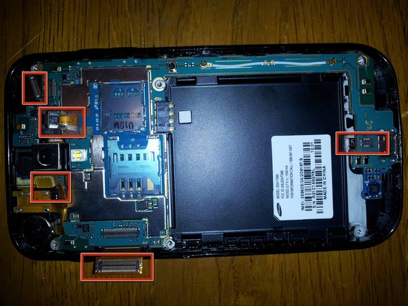

    • Unlatch the 5 ribbon connectors. This will make the motherboard ready to be removed.
    • Simply lift it out!
  5. Disassembling Samsung Galaxy s 2 (T-mobile)(T989) Phone: step 5, image 1 of 1
    • Unscrew the final screw up in the top right corner, holding the front facing camera in place
    • Remove the headphone jack (plus attached components) and front facing camera
    • They have sticky tape keeping them attached to the phone, so dont be afraid to pull!
