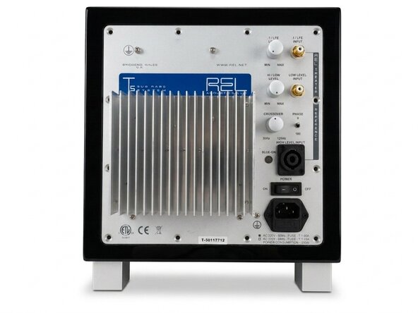

    1. Disassembling REL T5 Transformer, Remove screws: step 1, image 1 of 3 Disassembling REL T5 Transformer, Remove screws: step 1, image 2 of 3 Disassembling REL T5 Transformer, Remove screws: step 1, image 3 of 3
      • Place the subwoofer on it legs to protect the driver. Be careful not to touch the driver/speaker on the bottom when you handle the case.
      • Using the 3mm hex tool, remove only the outer rim of screws, starting from the bottom.
      • Make sure to support the plate amp by gripping the heat sink.
      • Remove the top screws. Be aware: the heavy transformer is located at the top. Removing the top screws will probably make the plate amp tilt out of the case.
      • Using the heatsink, carefully lift the plate amp out of the case. Again: it's heavier than you might expect!
