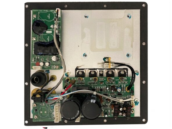

    6. Disassembling REL T5 Main Amplifier, Remove transformer: step 9, image 1 of 2 Disassembling REL T5 Main Amplifier, Remove transformer: step 9, image 2 of 2
      • You can now remove the transformer from the plate. Be careful not to damage the controls on the plate now that the assembly is a lot lighter.
      Ask FixBot
    1. Disassembling REL T5 Main Amplifier, Remove connectors: step 10, image 1 of 2 Disassembling REL T5 Main Amplifier, Remove connectors: step 10, image 2 of 2
      • Remove the connectors to the amp board.
      Ask FixBot
    2. Disassembling REL T5 Main Amplifier: step 11, image 1 of 2 Disassembling REL T5 Main Amplifier: step 11, image 2 of 2
      • Discharge the capacitor e.g. using a replacement 1k3 power resistor.
      • Carefully bridge the resistor across the + and - legs of the recifier, but don't touch anything else.
      Ask FixBot
      • Verify that the voltage is near zero. 0.2V or so is fine.
      • The voltage starts at around 100V, so be careful.
      Ask FixBot
    3. Disassembling REL T5 Main Amplifier, Remove component screws: step 13, image 1 of 2 Disassembling REL T5 Main Amplifier, Remove component screws: step 13, image 2 of 2
      • Remove the screws to the thermistor.
      • Remove the screws to the transistors.
      • Store them in a separate baggy.
      Ask FixBot
    4. Disassembling REL T5 Main Amplifier, Remove PCB screws: step 14, image 1 of 3 Disassembling REL T5 Main Amplifier, Remove PCB screws: step 14, image 2 of 3 Disassembling REL T5 Main Amplifier, Remove PCB screws: step 14, image 3 of 3
      • Remove screws for four corners.
      • Store them in or on their posts.
      Ask FixBot
    5. Disassembling REL T5 Main Amplifier, Lift the PCB: step 15, image 1 of 1
      • Gently lift up the PCB. The transistors might be held down by thermal paste, so use a spudger to release them.
      Ask FixBot
