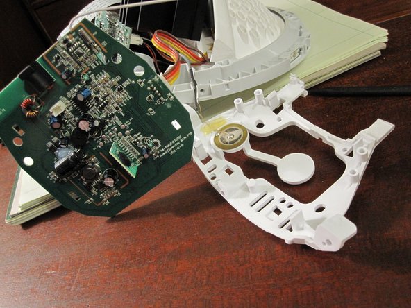

  7. Disassembling Philips Wake-Up HF35xx Main PCB, Unscrew main PCB's plastic holder: step 8, image 1 of 1
    • The "main PCB" is bottom-most of the circuit boards. It has the power input on it and the voltage regulator which often goes bad.
    • Remove the three screws at the base of the white plastic holder that is clipped into the main PCB. The circuit board will now lift slightly but be stopped by a ribbon cable.

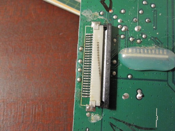

  8. Disassembling Philips Wake-Up HF35xx Main PCB, Detach ribbon cable: step 9, image 1 of 3 Disassembling Philips Wake-Up HF35xx Main PCB, Detach ribbon cable: step 9, image 2 of 3 Disassembling Philips Wake-Up HF35xx Main PCB, Detach ribbon cable: step 9, image 3 of 3
    • The ribbon cable can be released by pulling forward the tabs on the sides of the connector. Now the circuit board can swing to the side.
  9. Disassembling Philips Wake-Up HF35xx Main PCB, Detach plastic holder: step 10, image 1 of 2 Disassembling Philips Wake-Up HF35xx Main PCB, Detach plastic holder: step 10, image 2 of 2
    • Unclip the four clips holding the circuit board to the plastic holder.
    • Be careful as the piezo clicker will still be attached to the holder.

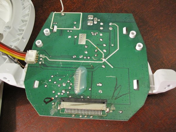

  10. Disassembling Philips Wake-Up HF35xx Main PCB, Unplug power output: step 11, image 1 of 2 Disassembling Philips Wake-Up HF35xx Main PCB, Unplug power output: step 11, image 2 of 2
    • Unplug the power connector (brown-red-orange-yellow wires) from the main PCB.
    • The main PCB is now free to be worked on, but be aware that the FM aerial dangles from a solder connection and can break off.
