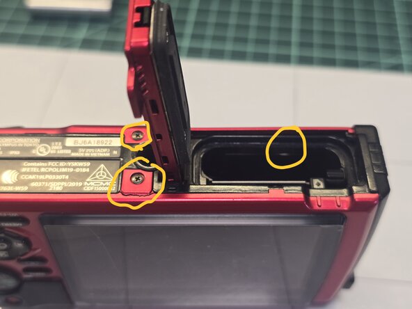

      • Remove the 5 screws on the outside, one screw in the battery compartment and one in the connector compartment
      • You can now remove the front cover

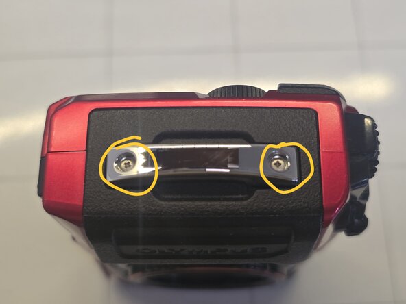

    3. Disassembling Olympus TG-6, Remove top cover: step 3, image 1 of 1
      • Remove both screws

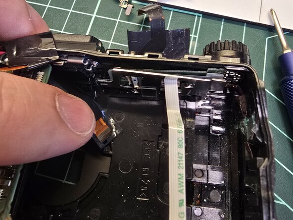

    5. Disassembling Olympus TG-6, Unlatched the small ribbon cable: step 5, image 1 of 2 Disassembling Olympus TG-6, Unlatched the small ribbon cable: step 5, image 2 of 2
      • Unlatched the small ribbon cable connecting the buttons pcb with the camera
      • After this you can open the camera carefully not to add strain to the still connected screen ribbon cable.
