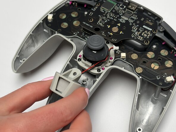

    4. Disassembling ModRetro M64 Pro Controller, Thumb Stick Gate: step 4, image 1 of 2 Disassembling ModRetro M64 Pro Controller, Thumb Stick Gate: step 4, image 2 of 2
      • To remove the thumb stick gate, remove three screws using a Tri-wing Y1 Screwdriver.
      • Pull the Gate away from the front panel and set aside.

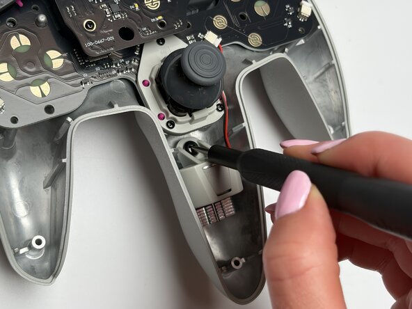

    5. Disassembling ModRetro M64 Pro Controller, Rumble Motor: step 5, image 1 of 3 Disassembling ModRetro M64 Pro Controller, Rumble Motor: step 5, image 2 of 3 Disassembling ModRetro M64 Pro Controller, Rumble Motor: step 5, image 3 of 3
      • To prevent damaging the board, use ESD protection
      • Unplug the Rumble Motor cable connector from the PCB.
      • Remove one screw holding down the motor using the Y1 Tri-wing screwdriver.
      • Lift the motor away and set aside.

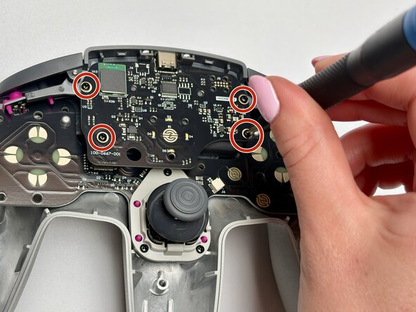

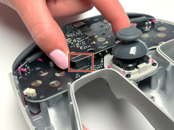

    6. Disassembling ModRetro M64 Pro Controller, Battery PCB: step 6, image 1 of 3 Disassembling ModRetro M64 Pro Controller, Battery PCB: step 6, image 2 of 3 Disassembling ModRetro M64 Pro Controller, Battery PCB: step 6, image 3 of 3
      • Unscrew four screws using a Tri-wing Y1 Screwdriver.
      • The upper battery PCB connects to the underlying main PCB via a board-to-board connector located near the bottom-left corner of the battery PCB (Image 2).
      • Gently wiggle the battery PCB to loosen up the connector before lifting the PCB vertically. Set them aside.

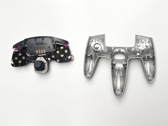

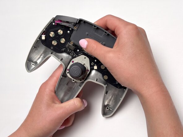

    7. Disassembling ModRetro M64 Pro Controller, Back Enclosure: step 7, image 1 of 3 Disassembling ModRetro M64 Pro Controller, Back Enclosure: step 7, image 2 of 3 Disassembling ModRetro M64 Pro Controller, Back Enclosure: step 7, image 3 of 3
      • Unscrew three screws around the joystick using a Tri-wing Y1 Screwdriver.
      • Grip the top of the battery compartment. Gently wiggle while pulling straight up to clear the two metal alignment pins and release the back enclosure.
      • You will experience some physical resistance here.
      • Separate the back enclosure from the PCB and battery compartment module, then set the enclosure aside.

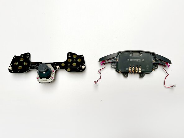

    8. Disassembling ModRetro M64 Pro Controller, Battery Compartment: step 8, image 1 of 2 Disassembling ModRetro M64 Pro Controller, Battery Compartment: step 8, image 2 of 2
      • Disconnect two off-white connectors on each side. Use your fingers or tweezers to disconnect the connector.
      • Separate the PCB from the Battery Compartment and set aside.

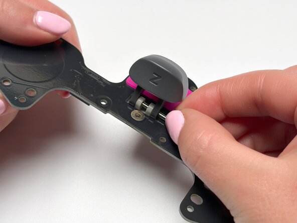

    11. Disassembling ModRetro M64 Pro Controller, Z Trigger: step 11, image 1 of 3 Disassembling ModRetro M64 Pro Controller, Z Trigger: step 11, image 2 of 3 Disassembling ModRetro M64 Pro Controller, Z Trigger: step 11, image 3 of 3
      • Push one side of the Z-trigger hinge pin and pull it out from the opposite side to remove it.
      • Gently pull the membrane from the PCB.
      • To reinstall the membrane, feed the alignment legs through their respective holes. Grip the legs from the other side and pull gently until they are fully seated.
      • Remove the front gray holder
