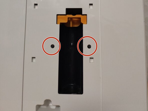

    1. Disassembling Miele CM7 Coffee Maker Unit case, Water tank side: step 1, image 1 of 2 Disassembling Miele CM7 Coffee Maker Unit case, Water tank side: step 1, image 2 of 2
      • Remove the cover by simply pulling it.
      • Unscrew 2 screws (T10).
