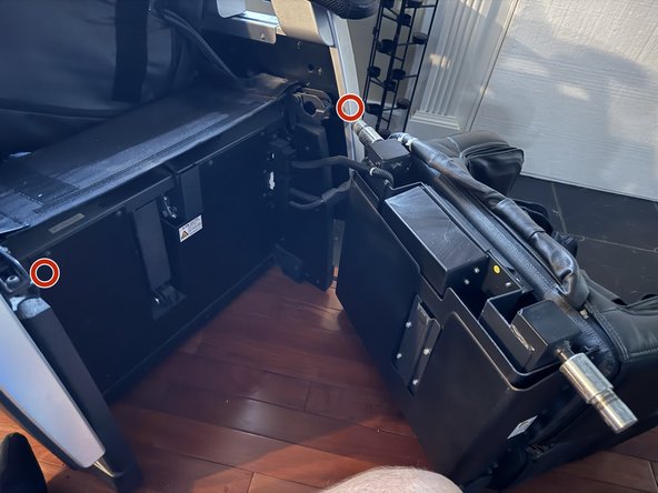

      • Use 5 mm hex to remove the two bolts to the left or the two circles in the drawing
      • then lift up on the securing points latches
      • then you can lift up slightly on the leg portion to move it away from the chair
      • carefully as it is still attached electrically
      • the leg portion does had wheels on it so it moves easily after you lift it free (it is quite heavy)

      • with a small flat head screw driver or similar, gently push the center of the connector toward the outside of the chair as you pull the entire connector forward.
      • There are two you need to disconnect to the right o the red squares.
      • 2nd and 3rd photos shows them disconnected
      • that is it now the leg portion can be rolled away. There are wheels on the bottom of it.
