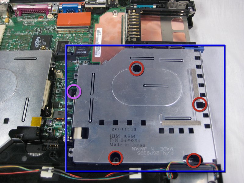

      • Locate the CD Drive Bay
      • Remove the three 5.6mm screws.
      • Remove the 16mm screw.
      • Lift the right side and pull the CD drive bay out.
      • The black lever will pop out.
