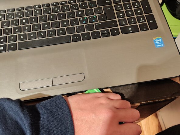

    1. Disassembling HP Notebook 15-ay087no Backplate, Take out the battery: step 1, image 1 of 2 Disassembling HP Notebook 15-ay087no Backplate, Take out the battery: step 1, image 2 of 2
      • Firstly we got to remove the battery to remove it we just gotta on the left side pull the tab to the right and then take it straight out by pulling back
      • Remember that on the right side it should should show an unlocked lock symbol instead of a locked one
