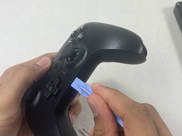

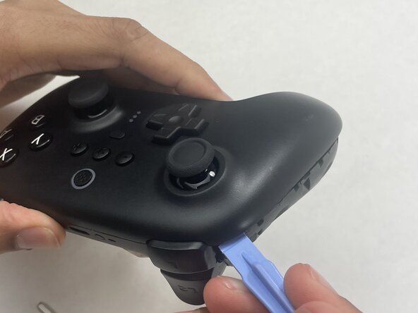

      • Insert an opening pick into the seam between the left controller grip and main controller body.
      • Pry the grip off.
      • Repeat for the right grip.
