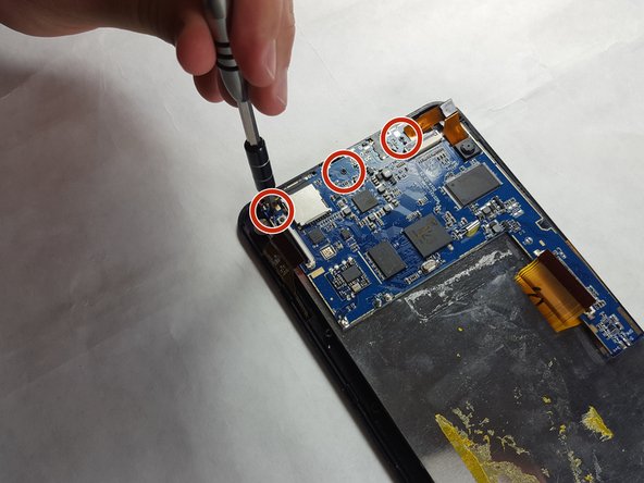

  9. DigiLand DL700D Motherboard Replacement: step 9, image 1 of 3 DigiLand DL700D Motherboard Replacement: step 9, image 2 of 3 DigiLand DL700D Motherboard Replacement: step 9, image 3 of 3
    • Remove the three 2.5 mm Phillips #1 screws holding the motherboard to the case.
  10. DigiLand DL700D Motherboard Replacement: step 10, image 1 of 3 DigiLand DL700D Motherboard Replacement: step 10, image 2 of 3 DigiLand DL700D Motherboard Replacement: step 10, image 3 of 3
    • Remove motherboard from the case and replace.
