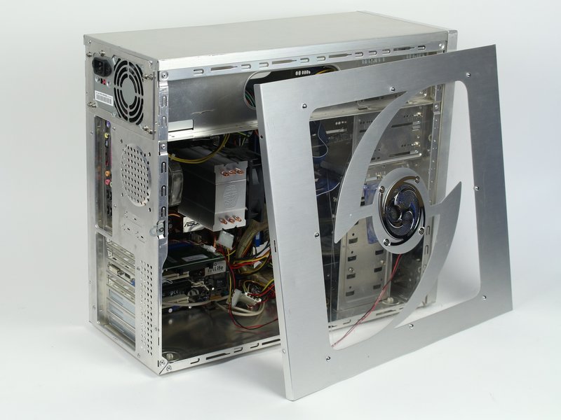

      • Unplug the computer from the power supply before any maintenance or disassembly.
      • Remove the two Phillips #2 head 5mm screws from the back side of the computer case. You only need to remove the screws that hold down the panel.
      • These screws can usually be removed by hand.
      • Be sure to wear an anti-static bracelet or use an anti-static mat to ensure important components are not damaged by static electricity.
      Ask FixBot
    2. Desktop PC Left Panel Replacement: step 2, image 1 of 2 Desktop PC Left Panel Replacement: step 2, image 2 of 2
      • Next, remove the side panel of the computer case to allow access into the computer. Slide the panel towards the back of the computer and lift it up to remove.
      • If there is a fan mounted on the side panel, make sure to unplug the cable before fully removing the panel.
