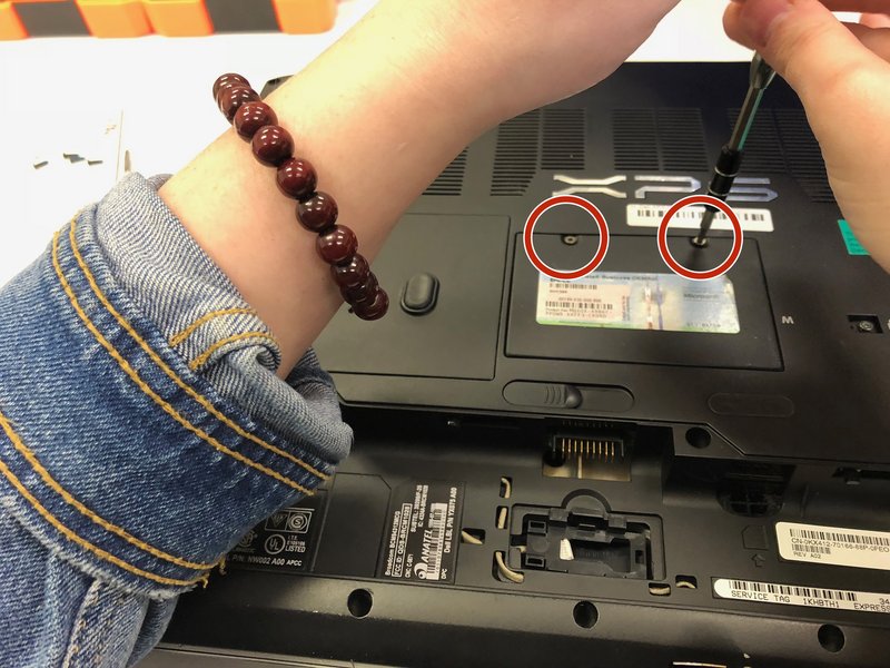

    1. Dell XPS M1730 RAM Replacement, RAM: step 4, image 1 of 1
      • Remove the two M2x3mm screws from the center panel on the back of computer with a Phillips #0 screwdriver head.
      Ask FixBot
