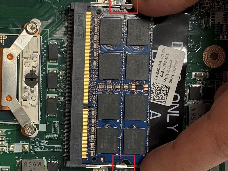

    2. Dell Studio 1558 RAM Replacement: step 6, image 1 of 2 Dell Studio 1558 RAM Replacement: step 6, image 2 of 2
      • Two small tabs are located on either side of the RAM stick. Push those tabs inwards to release the RAM stick.
      • A new RAM stick can be inserted by inserting the golden pins into the slot, and then lowering the rest of the RAM stick into the slot.
