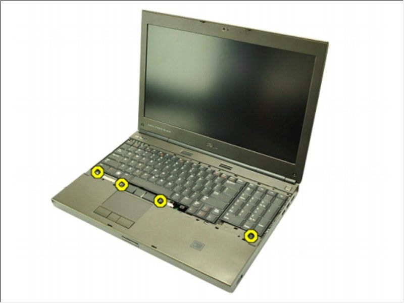

    1. Dell Precision M4600 KeyBoard Replacement, KeyBoard: step 3, image 1 of 3 Dell Precision M4600 KeyBoard Replacement, KeyBoard: step 3, image 2 of 3 Dell Precision M4600 KeyBoard Replacement, KeyBoard: step 3, image 3 of 3
      • Remove the screws securing the keyboard in place.
      • Starting from the bottom of the keyboard, separate the keyboard from the system and turn the keyboard over.
      • Disconnect the keyboard data cable from the system board.
      Ask FixBot
