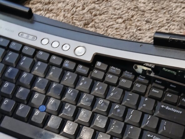

    1. Dell Precision M4300 Keyboard Replacement, Remove button trim.: step 1, image 1 of 2 Dell Precision M4300 Keyboard Replacement, Remove button trim.: step 1, image 2 of 2
      • Use a spudger to remove the trim
