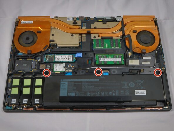

    3. Dell Precision 7750 GPU Replacement: step 3, image 1 of 2 Dell Precision 7750 GPU Replacement: step 3, image 2 of 2
      • Remove three screws from the battery using a Phillips #0 screwdriver.

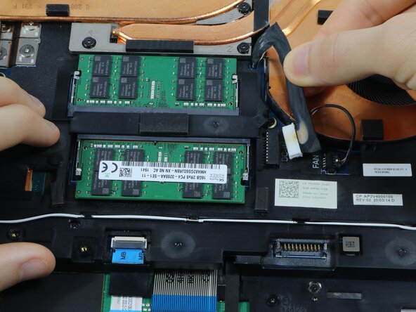

    7. Dell Precision 7750 GPU Replacement: step 7, image 1 of 3 Dell Precision 7750 GPU Replacement: step 7, image 2 of 3 Dell Precision 7750 GPU Replacement: step 7, image 3 of 3
      • Detach the two fan connectors.
      • Pull the connectors in a straight motion to avoid component damage.

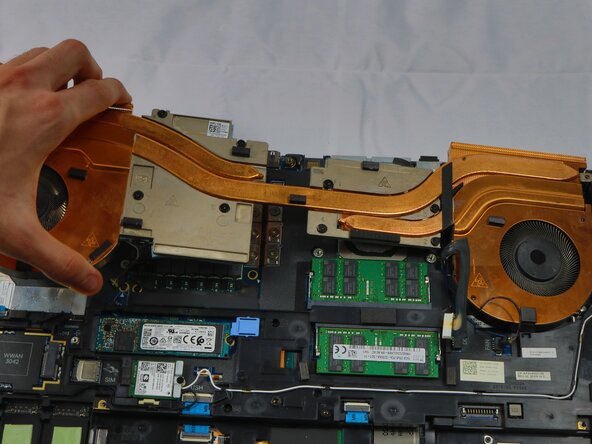

    9. Dell Precision 7750 GPU Replacement: step 9, image 1 of 1
      • Carefully remove the copper heatsink.
      Ask FixBot

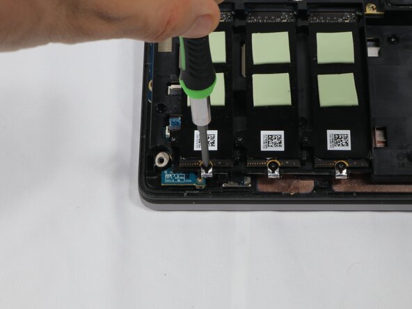

    13. Dell Precision 7750 GPU Replacement: step 13, image 1 of 3 Dell Precision 7750 GPU Replacement: step 13, image 2 of 3 Dell Precision 7750 GPU Replacement: step 13, image 3 of 3
      • Remove six screws holding the M.2 drives using a Phillips #0 screwdriver.

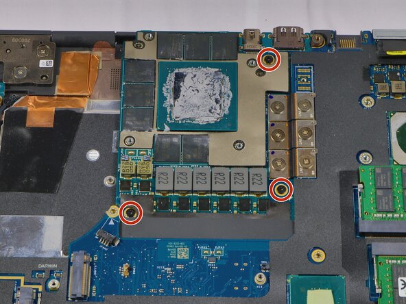

    21. Dell Precision 7750 GPU Replacement: step 21, image 1 of 2 Dell Precision 7750 GPU Replacement: step 21, image 2 of 2
      • Remove three screws from the GPU using a Phillips #0 screwdriver.
      • Take extra care not to unintentionally strip the screw heads, as these three screws are responsible for holding the GPU securely in place.
