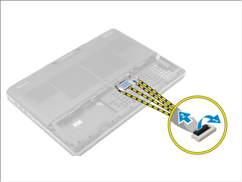

    1. Dell Precision 7510 KeyBoard Replacement, Removing the Keyboard Cables: step 5, image 1 of 1
      • Peel the tape to access the cable.
      • Lift the tab and disconnect the keyboard cables from the system board.
      Ask FixBot
