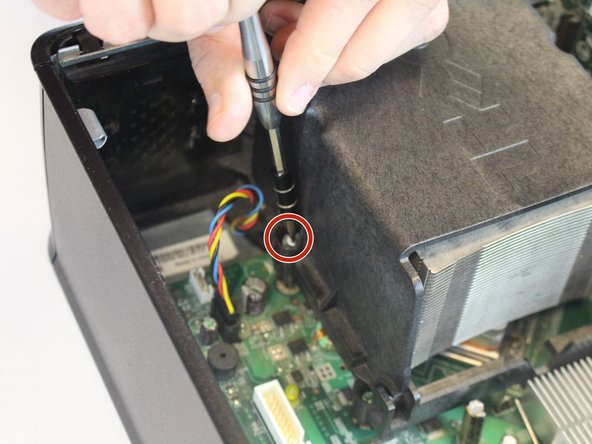

  4. Dell Optiplex 745 Small Form Factor Processor Replacement: step 4, image 1 of 3 Dell Optiplex 745 Small Form Factor Processor Replacement: step 4, image 2 of 3 Dell Optiplex 745 Small Form Factor Processor Replacement: step 4, image 3 of 3
    • Unscrew the 9.5 mm screws from heatsink on both sides using the Phillips #2 screwdriver.
    • If the processor is glued on to the heat sink, gently scrape off the glue and detach it from the device.

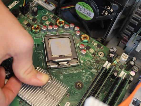

  5. Dell Optiplex 745 Small Form Factor Processor Replacement: step 5, image 1 of 3 Dell Optiplex 745 Small Form Factor Processor Replacement: step 5, image 2 of 3 Dell Optiplex 745 Small Form Factor Processor Replacement: step 5, image 3 of 3

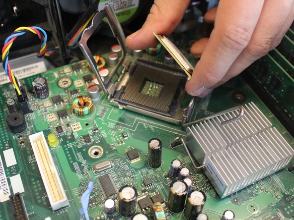

    • Push the small lever downwards, then sideways and upwards, in order to release it from the hook.
    • Remove the processor from its casing.
