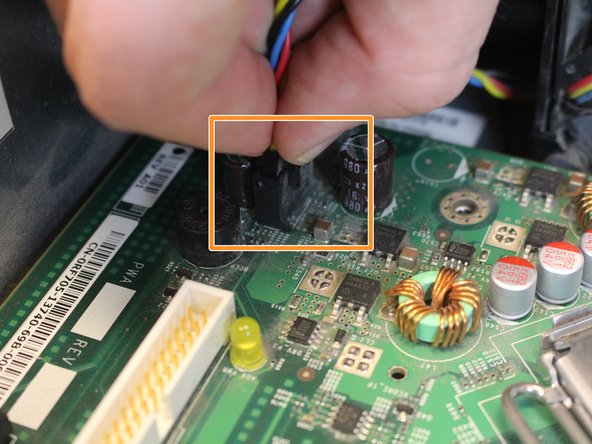

  3. Dell Optiplex 745 Small Form Factor Motherboard Replacement, Motherboard: step 3, image 1 of 3 Dell Optiplex 745 Small Form Factor Motherboard Replacement, Motherboard: step 3, image 2 of 3 Dell Optiplex 745 Small Form Factor Motherboard Replacement, Motherboard: step 3, image 3 of 3
    • Disconnect all of the cords that are connected to the motherboard.
    • Press in the lever on the side of the male end, and then pull out.
    • Pull cord straight out.
    • Disconnect the front plate (USB and audio output) from the motherboard.
    • Some of the cords in the pictures are missing due to the condition of our device when creating this guide.

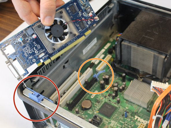

  4. Dell Optiplex 745 Small Form Factor Motherboard Replacement: step 4, image 1 of 3 Dell Optiplex 745 Small Form Factor Motherboard Replacement: step 4, image 2 of 3 Dell Optiplex 745 Small Form Factor Motherboard Replacement: step 4, image 3 of 3
    • Remove the graphics card.
    • Lift the blue latch on the fat end of the graphics card.
    • Pull the blue lever on the skinny end of the graphics card toward the power supply.
    • Pull out one end of the card at a time.

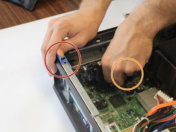

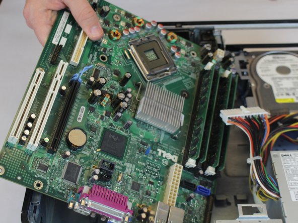

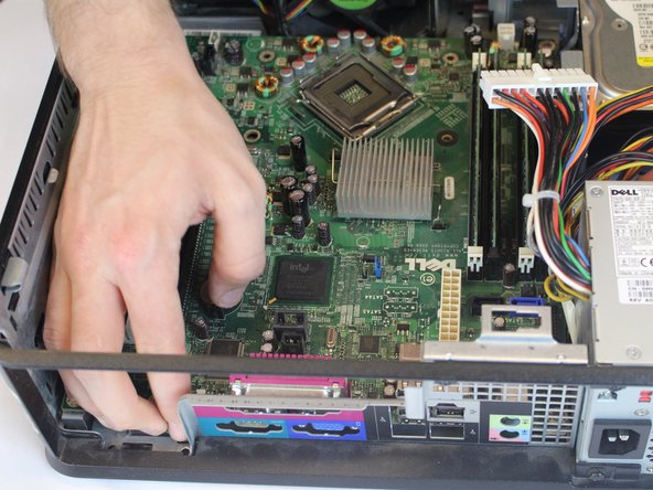

  7. Dell Optiplex 745 Small Form Factor Motherboard Replacement: step 7, image 1 of 3 Dell Optiplex 745 Small Form Factor Motherboard Replacement: step 7, image 2 of 3 Dell Optiplex 745 Small Form Factor Motherboard Replacement: step 7, image 3 of 3
    • Remove the back plate by lifting straight out by the blue latch that secures the graphics card.
    • Pull the end of the motherboard closest to the back of the computer away from the static back plate.
    • Lift this end away and out of the case.
