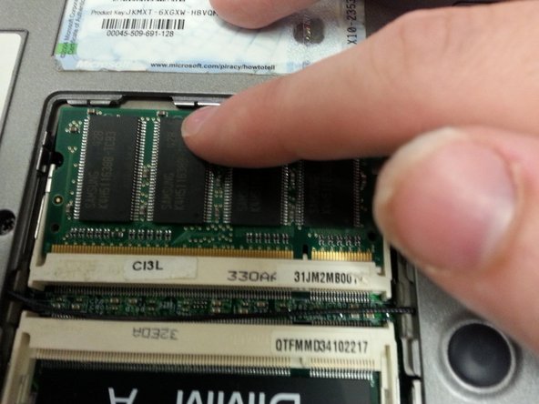

    4. Dell Latitude D600 RAM (Main Memory) Replacement: step 7, image 1 of 3 Dell Latitude D600 RAM (Main Memory) Replacement: step 7, image 2 of 3 Dell Latitude D600 RAM (Main Memory) Replacement: step 7, image 3 of 3
      • To add or replace RAM, place the memory into the slot at an angle
      • Make sure you line it up correctly
      • If it is in correctly it should stay up at an angle by itself
      • Then push down in the middle until it clicks into place

    5. Dell Latitude D600 RAM (Main Memory) Replacement: step 8, image 1 of 1
      • The RAM should be secured by the tabs where the two semi circles are on the RAM
      • If it is not secure, just gently pull it out and try again, use the images to help you out
