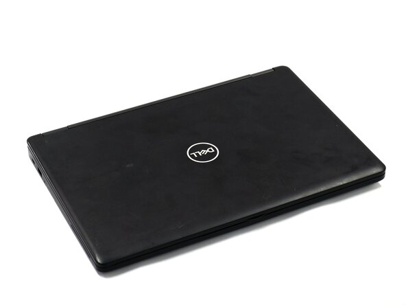

Close the device and flip the laptop over so the backplate is facing up.

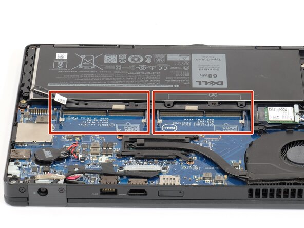

Your Dell Latitude 5490 laptop has 2 RAM slots.
Carefully pull the two small metal clips on the sides of the RAM module you are trying to remove.
