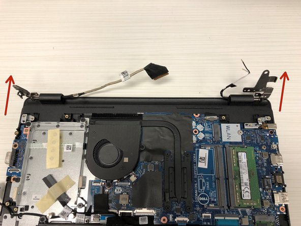

    5. Dell Latitude 3400  Screen Assembly Replacement, Release Hinges: step 5, image 1 of 3 Dell Latitude 3400  Screen Assembly Replacement, Release Hinges: step 5, image 2 of 3 Dell Latitude 3400  Screen Assembly Replacement, Release Hinges: step 5, image 3 of 3
      • Remove the screws in both the right and left hinges.
      • Lift hinges up and pull the lid out from under laptop.
      Ask FixBot
    6. Dell Latitude 3400  Screen Assembly Replacement, Finished: step 6, image 1 of 1
      • If everything has gone smoothly, you will have been able to separate the screen assembly from the base.
