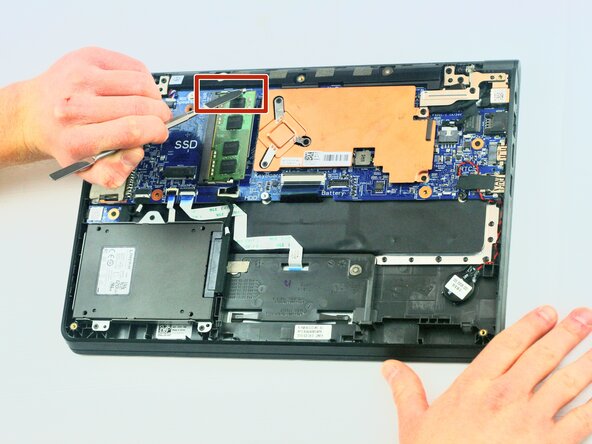

    1. Dell Latitude 3150 RAM Replacement, RAM: step 3, image 1 of 3 Dell Latitude 3150 RAM Replacement, RAM: step 3, image 2 of 3 Dell Latitude 3150 RAM Replacement, RAM: step 3, image 3 of 3
      • Using the metal spudger, push the pins on the sides of the RAM out.
      • The RAM will pop out; carefully remove it from the laptop.
