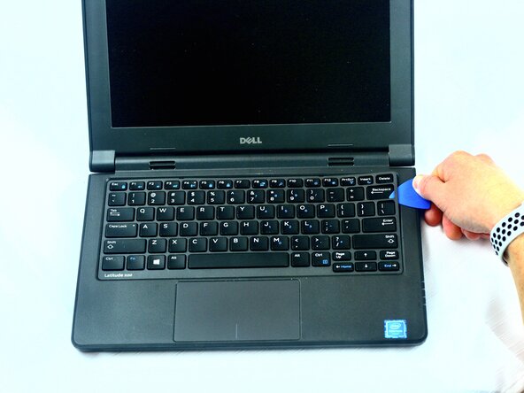

    1. Dell Latitude 3150 Keyboard Replacement, Keyboard: step 3, image 1 of 1
      • Using an opening pick, carefully pry up and unsnap the keyboard bezel.
