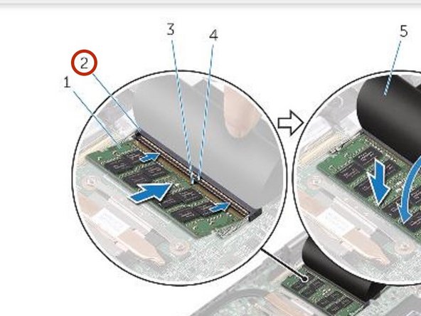

    1. Dell Inspiron 5379 Memory Modules Replacement, Lifting the Mylar: step 1, image 1 of 1
      Ask FixBot
    2. Dell Inspiron 5379 Memory Modules Replacement, Popping up the Memory Module: step 2, image 1 of 3 Dell Inspiron 5379 Memory Modules Replacement, Popping up the Memory Module: step 2, image 2 of 3 Dell Inspiron 5379 Memory Modules Replacement, Popping up the Memory Module: step 2, image 3 of 3
      • Use your fingertips to carefully spread apart the securing-clips on each end of the memory-module slot until the memory module pops up.
      Ask FixBot
    3. Dell Inspiron 5379 Memory Modules Replacement, Lifting the Mylar: step 3, image 1 of 1
      • Lift the Mylar to access the memory-module slot.
      Ask FixBot
    4. Dell Inspiron 5379 Memory Modules Replacement, Align the Notch: step 4, image 1 of 1
      • Align the notch on the memory module with the tab on the memory-module slot.
      Ask FixBot
    5. Dell Inspiron 5379 Memory Modules Replacement, Sliding the Memory Module: step 5, image 1 of 2 Dell Inspiron 5379 Memory Modules Replacement, Sliding the Memory Module: step 5, image 2 of 2
      • Slide the memory module firmly into the slot at an angle and press the memory module down until it clicks into place.
      • NOTE: If you do not hear the click, remove the memory module and reinstall it.
