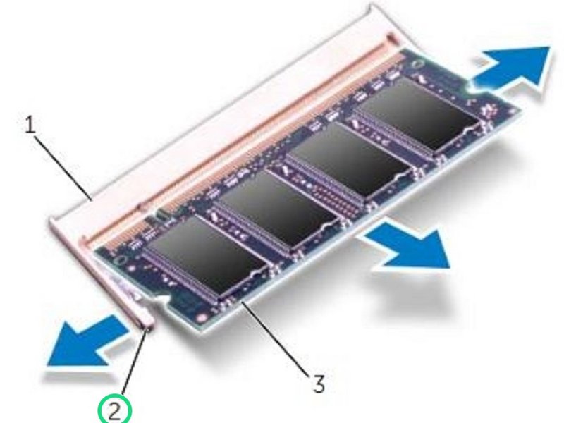

    1. Dell Inspiron 15R 5520 Memory Module Replacement, Popping up the Memory Module: step 1, image 1 of 2 Dell Inspiron 15R 5520 Memory Module Replacement, Popping up the Memory Module: step 1, image 2 of 2
      • WARNING: Before working inside your computer, read the safety information that shipped with your computer and follow the steps in "Before You Begin".
      • CAUTION: To prevent damage to the memory-module connector, do not use tools to spread the memory-module securing clips.
      • Use your fingertips to carefully spread apart the securing clips on each end of the memory-module connector until the memory module pops up.
