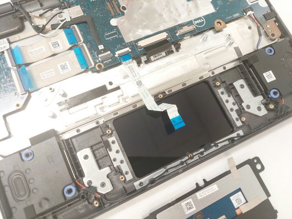

  5. Dell Chromebook 3100 2-in-1 Touchpad Replacement: step 5, image 1 of 1
    • Once again, use the PH1 bit for your screwdriver to unscrew the 6 Phillips head screws holding down the touch-pad.
  6. Dell Chromebook 3100 2-in-1 Touchpad Replacement: step 6, image 1 of 1
    • With all the screws removed, lift out the metal bracket holding down the touch-pad.
  7. Dell Chromebook 3100 2-in-1 Touchpad Replacement: step 7, image 1 of 1
    • Next is to unplug the ribbon cable connecting to the touch-pad.
    • This can be done by flipping the black tab up and gently tugging on the blue handle to remove it.
    • The ribbon cable is very fragile! Be very careful when unplugging it!
  8. Dell Chromebook 3100 2-in-1 Touchpad Replacement: step 8, image 1 of 2 Dell Chromebook 3100 2-in-1 Touchpad Replacement: step 8, image 2 of 2
    • With the cable unplugged and the metal bracket removed, grab the touch-pad along its edges and lift it off of the laptop.
