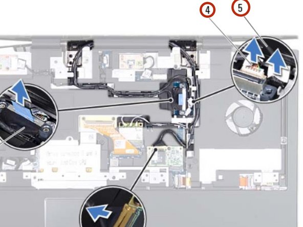

  3. Dell Alienware M17x R3 Display Assembly Replacement, Disconnecting the Camera Cable: step 3, image 1 of 1
    • Disconnect the camera cable and infrared cable from the respective system board connectors.
  4. Dell Alienware M17x R3 Display Assembly Replacement, Remove the Cables: step 4, image 1 of 2 Dell Alienware M17x R3 Display Assembly Replacement, Remove the Cables: step 4, image 2 of 2
    • Note the routing of the display cable, camera cable, infrared cable, wirelessHD card cable, Mini-Card antenna cables and remove the cables from the routing guides on the palm rest assembly.

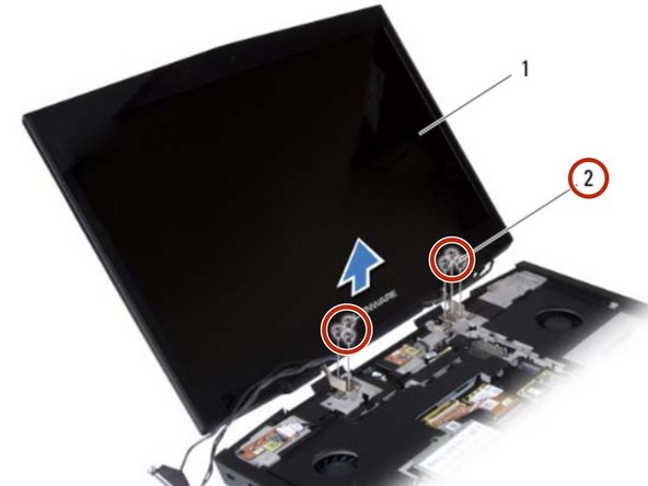

  5. Dell Alienware M17x R3 Display Assembly Replacement, Remove the Screws: step 5, image 1 of 1
    • Remove the six screws that secure the display assembly to the computer base.
  6. Dell Alienware M17x R3 Display Assembly Replacement, Removing the Display Assembly: step 6, image 1 of 1
    • Lift the display assembly off the computer.
  7. Dell Alienware M17x R3 Display Assembly Replacement, Securing the Display Assembly: step 7, image 1 of 2 Dell Alienware M17x R3 Display Assembly Replacement, Securing the Display Assembly: step 7, image 2 of 2
    • Place the NEW display assembly in position and replace the six screws that secure the display assembly to the computer base.
  8. Dell Alienware M17x R3 Display Assembly Replacement, Route the Cables: step 8, image 1 of 2 Dell Alienware M17x R3 Display Assembly Replacement, Route the Cables: step 8, image 2 of 2
    • Route the display cable, camera cable, infrared cable, wirelessHD card cable, and Mini-Card antenna cables through the routing guides on the palm rest assembly.
