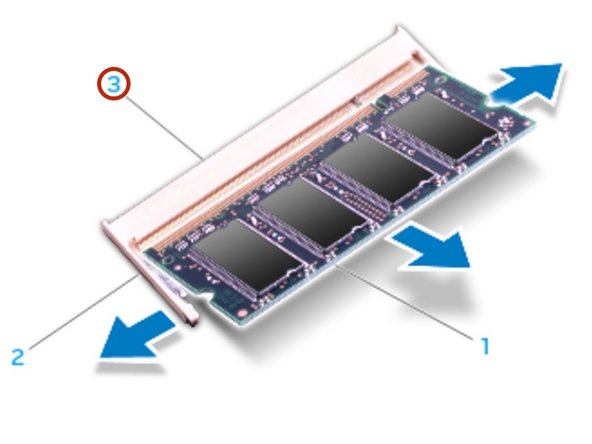

    2. Dell Alienware M17x Memory Modules Replacement, Popping up the Memory Module: step 2, image 1 of 3 Dell Alienware M17x Memory Modules Replacement, Popping up the Memory Module: step 2, image 2 of 3 Dell Alienware M17x Memory Modules Replacement, Popping up the Memory Module: step 2, image 3 of 3
      • CAUTION: If you need to remove memory modules from both connectors, remove the memory module in the upper connector before you remove the module in the lower connector.
      • Use your fingertips to carefully spread apart the spring-locks on the memory module connector until the module pops up.
      Ask FixBot
    3. Dell Alienware M17x Memory Modules Replacement, Removing the Memory Module: step 3, image 1 of 1
      • Remove the memory module.
