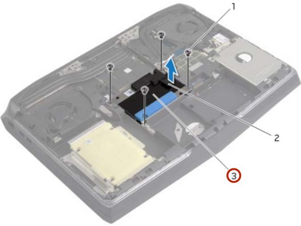

  17. Dell Alienware 17 Memory Modules 1 & 2 Replacement, Remove the Screws: step 17, image 1 of 2 Dell Alienware 17 Memory Modules 1 & 2 Replacement, Remove the Screws: step 17, image 2 of 2
    • WARNING: Before working inside your computer, read the safety information that shipped with your computer and follow the steps in Before Working Inside Your Computer. . After working inside your computer, follow the instructions in After Working Inside Your Computer.
    • CAUTION: To avoid data loss, do not remove the hard drive while the computer is On or in Sleep state.
    • CAUTION: Hard drives are extr emely fragile. Exercise care when handling the hard drive.
    • Remove the screws that secure the hard-drive assembly to the computer base.
    Ask FixBot

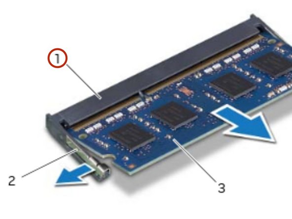

  44. Dell Alienware 17 Memory Modules 1 & 2 Replacement, Popping up the Memory Module: step 44, image 1 of 1
    • Using your fingertips, carefully spread apart the securing clips at the sides of the memory-module connector until the memory module pops up.
    Ask FixBot
  45. Dell Alienware 17 Memory Modules 1 & 2 Replacement, Slide and Remove: step 45, image 1 of 2 Dell Alienware 17 Memory Modules 1 & 2 Replacement, Slide and Remove: step 45, image 2 of 2
    • Slide and remove the memory module from the memory-module connector.
    Ask FixBot
