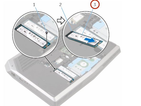

      • Remove the screw that secures the solid-state drive to the computer base.

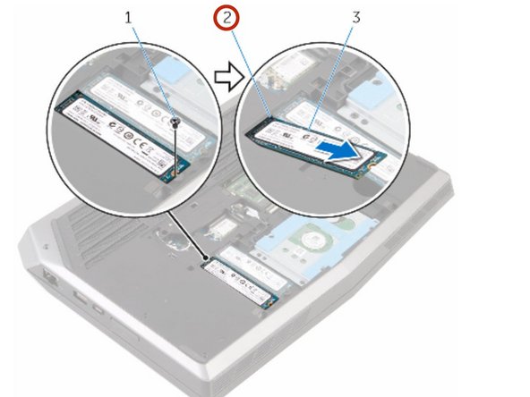

      • Slide and remove the solid-state drive from the solid-state drive slot.

      • Slide the NEW solid-state drive into the solid-state drive slot.

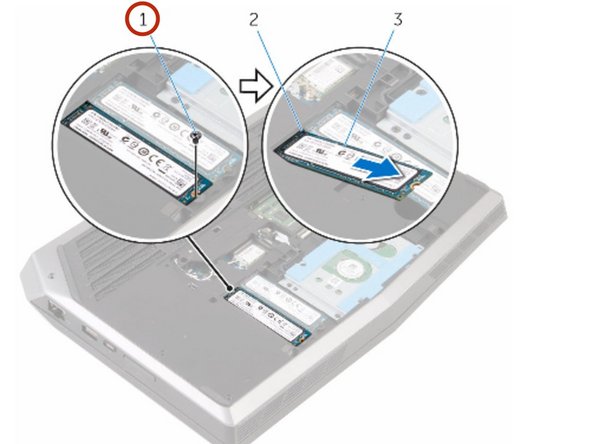

      • Align the screw hole on the solid-state drive with the screw hole on the computer base.

      • Replace the screw that secures the solid-state drive to the computer base.
